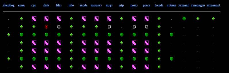

Hi Devvkanth,
looking at the pic you sent it looks like all you're actually checking on all machines other than the server is remote checks - conn & ntp. Other than that, everything is purple so that means that your clients are not sending their statuses to the xymon server. So please check that and get to a state where all your checks are either green, yellow, red or white. If they're purple, it means that you did receive some data in the past but you're no longer receiving data for those checks. Sample screenshot here: https://ibb.co/djX5Tzc<https://apac01.safelinks.protection.outlook.com/?url=https%3A%2F%2Fibb.co%2FdjX5Tzc&data=user-77322baadbba@xymon.invalid%7C60c16639798c4cd620f608d68df1e9d3%7C63ce7d592f3e42cda8ccbe764cff5eb6%7C1%7C0%7C636852467514360832&sdata=v9oBMfSWAi8x2%2BEM6w%2BR4vYk64N%2Fre1yfpSWmB2tUlY%3D&reserved=0>;
As for the uptime check, Xymon's uptime check is bundled within the CPU check in the UI, although you can alert on it separately. Sample screenshot here: https://ibb.co/745XLgT<https://apac01.safelinks.protection.outlook.com/?url=https%3A%2F%2Fibb.co%2F745XLgT&data=user-77322baadbba@xymon.invalid%7C60c16639798c4cd620f608d68df1e9d3%7C63ce7d592f3e42cda8ccbe764cff5eb6%7C1%7C0%7C636852467514360832&sdata=SAyfZINNZRu6lyikTsSvZI1ds%2Bp3ezaue5xUtG9DMYg%3D&reserved=0>;

I have removed the uptime from hosts.cfg file and  --uptime-status is inserted in tasks.cfg. yet I do not see the uptime column in it . Please check below, I have tried all the resolution available on the net, but I m not able to figure this one out.
[cid:image002.png at 01D4C009.A257AAC0]
