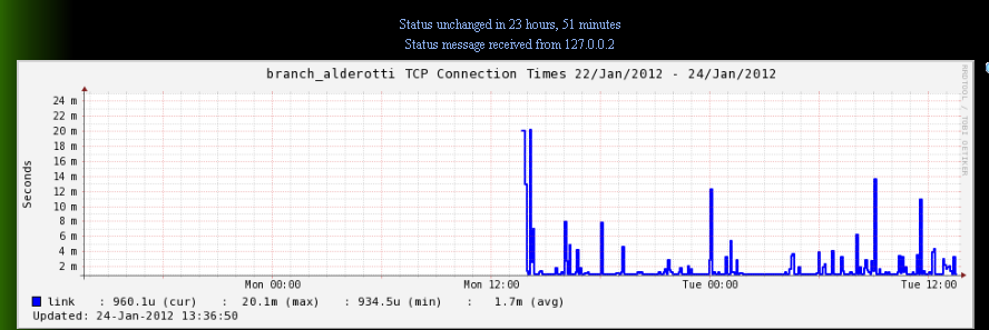

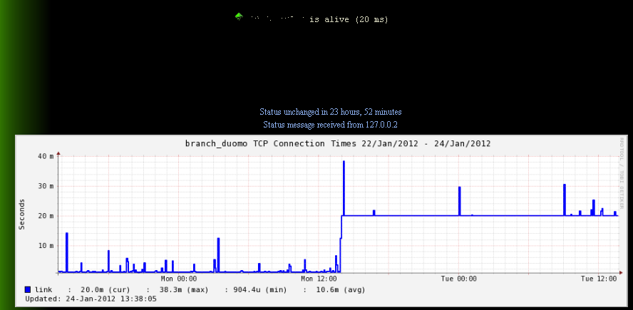

For the conn test, i have tried also to install fping instead of xymonping, but i have the same problems: response time from xymon are always more high respect the values that i obtain from command line, and not "dynamic":
Genraly only for one host, the values are corrected
For the other hosts, a value (20 ms X 1 or x 2) randomly seems added to response time
Host OK:
Host not Ok:
