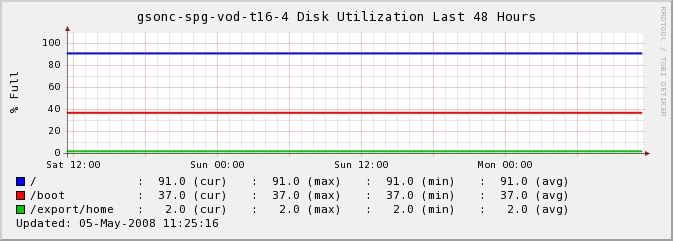

In hobbitserver.cfg, search for "BBSERVERHOSTNAME" and "BBSERVERIP".  What
is listed for those two?
▸ quoted from Frank M. Ramaekers
On Dec 28, 2007 3:17 PM, Frank M. Ramaekers <user-dbd5c100cfe9@xymon.invalid> wrote:
 Hobbitlaunch.log:
2007-12-28 13:56:29 hobbitlaunch starting
2007-12-28 13:56:29 Loading tasklist configuration from
/usr/libexec/hobbit/server/etc/hobbitlaunch.cfg
2007-12-28 13:56:29 Loading hostnames
2007-12-28 13:56:29 Loading saved state
2007-12-28 13:56:29 Setting up network listener on 0.0.0.0:1984
2007-12-28 13:56:29 Setting up signal handlers
2007-12-28 13:56:29 Setting up hobbitd channels
2007-12-28 13:56:29 Setting up logfiles
Hobbitd.log:
2007-12-28 14:16:31 hobbitd servername MACHINE='Hobbit' not listed in
bb-hosts, dropping hobbitd status
Hmmm….case sensitive?   Need FQDN?   Where is it getting this from?

We already told you what your problem was - merge those two hosts you
printed from your bb-hosts into one and you'll be set.
Josh

Or, how about runtime.cfg:
BBDISP="10.2.0.99"
BBDISPLAYS=""
(should something be in BBDISPLAYS?
