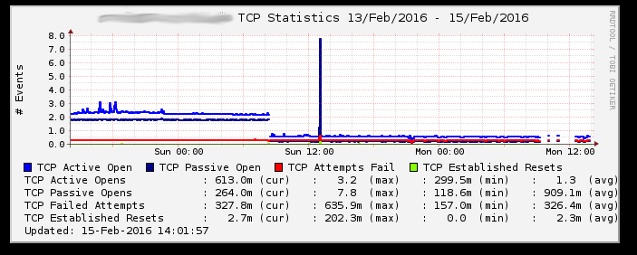

I'm a bit confused on what exactly this TCP Statistics graph is saying
(image attached).
What exactly are the units in this graph?
The y axis shows ~1-2 events but the legend shows 100-600"m".  What is the
magnitude of "m" exactly?
Do the numbers in the legend not line up with the graph axis units? Is
there a reason for this?
I would greatly appreciate if anyone could clear this up for me!
Thanks!!
Matt Vander Werf
list Japheth Cleaver · Tue, 16 Feb 2016 14:55:50 -0800 ·
The 'm' is 'milli' in this case, I believe.
The TCP values below are of a 'DERIVE' type, so you're seeing the rate of
events as counted by one of the [netstat] commands (-s). The rate should
be per second (which should probably be clarified in that label).
On an idle VM that's not doing much, that might be under 1 event a second.
