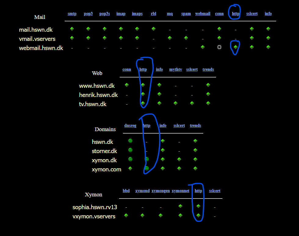

Could this be a firewall port issue? You mean from the xymon server ?
What results does your Xymon Server show on it's web dashboard?  Is it red? Green? Not working at all? Its green as shown below:
[cid:image001.png at 01D8FE96.D0FD2470]
  What are
your expected results, vs the results you're actually getting? I would have like to see an Https status icon which im not seeing here. Similar to this as shown below
[cid:image002.png at 01D8FE97.059CD270]

Does your Xymon Server actually know what the 'printspooler' name resolves to?? I'd back up a bit and run a ping test from your Xymon Server to your Printspooler Server and make sure something is happening successfully.? Then run nmap from Xymon to Printspooler to make sure it's answering on your desired port.? There's been a few instances on my stuff that I've had to statically enter an IP and hostname into my /etc/hosts file on my Xymon Server so it will correctly resolve something local that it couldn't find on it's own.
I also use the 'noconn' flag on a lot of my stuff so it doesn't try to resolve my custom host names to any IP unless I specifically want it to.? Here's a sample of some of my working host lines.? Maybe it will help you.
0.0.0.0???????? test.response.myurl.gov-healthcheck????????? # noconn https://test.response.myurl.gov/test/rest/info/healthCheck?f=pjson cont;https://test.response.myurl.gov/test/rest/info/healthCheck?f=pjson;true
192.168.50.22 ? QB-Sharepoint????????????????? # noconn httpstatus;http://matrix:9090;401;

What results do you get from your URL when using a standard web browser
from a different machine?? Does the page resolve correctly?
The page opens up so that I can log in.
What results does your Xymon Server show on it's web dashboard?? Is it red? Green? Not working at all? Its green as shown below:
? What are
Kris Springer
On 11/22/22 8:09 AM, Nikesh Maharaj wrote:
Noted thank you for your response. Will try the / at the end of the
url and check if it actually returns anything.
Im not getting any errors or am I looking at the wrong log file?
