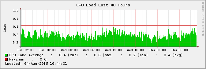

And just by way of example, you can use a VDEF to show the peak of a graph
such as with this alternative [la] graph definition:
[la]
        TITLE CPU Load
        YAXIS Load
        DEF:avg=la.rrd:la:AVERAGE
        CDEF:la=avg,100,/
        AREA:la#00CC00:CPU Load Average
        -u 1.0
        GPRINT:la:LAST: \: %5.1lf (cur)
        GPRINT:la:MAX: \: %5.1lf (max)
        GPRINT:la:MIN: \: %5.1lf (min)
        GPRINT:la:AVERAGE: \: %5.1lf (avg)\n
        VDEF:laMax=la,MAXIMUM
        LINE:laMax#CC0000:Maximum
        GPRINT:laMax: \: %5.1lf\n
The only additions here are the last three lines.
Resultant graph:
[image: pasted1]
The red line will be at different levels over different timeframes, but
always with the same value as the largest point on the graph.
Once you have your VDEF variable defined like this, you can percentivise
your DEF or CDEF variable into it, and graph that instead (as an exercise
for the reader).
