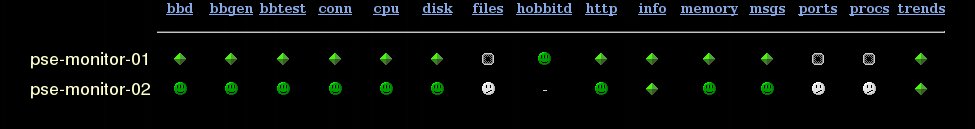

list J. Bobby Lopez · Mon, 3 Nov 2008 16:50:09 -0500 ·
I guess with Hobbit 4.2.0, there is no 'etc/hobbitclient.cfg', as it
has been replaced by 'hobbit-clients.cfg' ?
When I configure my two Hobbit servers as discussed below, I see that
there is only one server which lists the 'hobbitd' service.  The other
one ishows ' - '.
Is this normal?  Is the general idea that if both Hobbit servers are
in-sync, that 'hobbitd' on a per-system basis is irrelevant, and so it
only shows one?
(screenshot attached)

list J. Bobby Lopez · Fri, 7 Nov 2008 13:38:29 -0500 ·
Just re-sending this to engage anyone who may have missed it.   Has no one
come across this?

list Sebastian Auriol · Thu, 13 Nov 2008 18:41:13 -0000 ·
I have the same issue.  Maybe whatever it is (client?) that sends the data
for bbgen and bbtest (and bbproxy if available) to the other hobbit server
misses out the hobbitd data for some reason?
SebA
