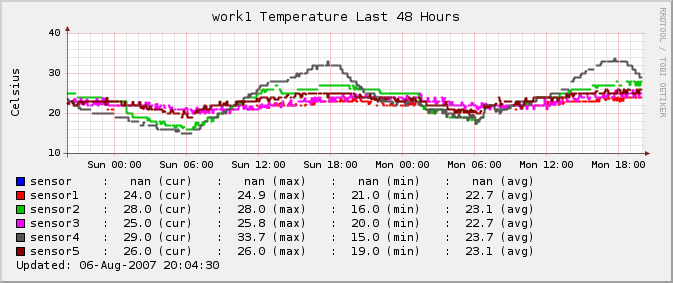

list Rolf Masfelder · Mon, 6 Aug 2007 20:10:01 +0200 ·
Am Montag, 6. August 2007 19:47 schrieb Charles Jones:
▸ quoted from Charles Jones
Not at all.  I'm sure other folks with linux servers could find it
handy.  I'm even using it to trend the temperature in my home office
You mean something like this:
The script originaly based on temperature.sh but now I am reading some
1wire devices using fuse / OWFS.
