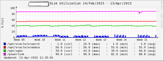

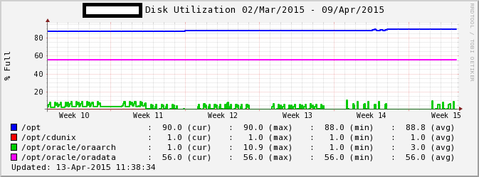

last week a colleague turned my attention to the graphs that are shown below the
single tests, like cpu, disk etc.
First I have to say that the problem seems only to occur if you have more than
10 file systems mounted.
He told me that if he clicks on a graph beneath the test because he wants to
check the utilisation of a file system everything seems to be fine at first but
when he zooms into the graph suddenly other file systems are shown but not the
one he wanted to take a look.
If he tries the same on the trends page it seems to work.
I was able to verify this behaviour with XYmon 4.3.12 and XYmon 4.3.18
(Unfortunately I only have these 2 versions running at the moment).
See attached screenshots.
Can someone else verify this?
If this is a bug (seems that there are different sort algorithms used on the
test page and the trends page) how can I disable the graphs on the test pages
and only rely on the ones that are displayed on the trends page.

list Torsten Richter · Mon, 13 Apr 2015 12:56:22 +0200 (CEST) ·
Ok, now the screenshots are attached.
Sorry.
