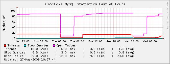

I can't help with the multiple graphs on one page; I have mine set up
for one graph on the page.
If you're intererested, I can send you my version of bb-mysqlstat.sh
(heavily modified from the one available on Deadcat.net .... )
Here are the relevant parts from hobbitserver.cfg:
NCV_mysql="Threads:GAUGE,SlowQueries:GAUGE,OpenTables:GAUGE,FlushTables:
NONE,Questions:NONE,Opens:NONE,AvgQuerysPerSecond:NONE,Uptime:NONE,FreeB
ufferPool:NONE"
GRAPHS="la,disk,inode,qtree,files,processes,memory,users,vmstat,iostat,t
cp.http,tcp,ncv,netstat,ifstat,mrtg::1,ports,temperature,ntpstat,apache,
bind,sendmail,mailq,socks,bea,iishealth,citrix,bbgen,bbtest,bbproxy,hobb
itd,clock,lines,mysql"
Here is the stanza from my hobbitgraph.cfg for the mysql graphs:
[mysql]
        TITLE MySQL Statistics
        YAXIS Number of
        DEF:threads=mysql.rrd:Threads:AVERAGE
        DEF:slow=mysql.rrd:SlowQueries:AVERAGE
        DEF:opentables=mysql.rrd:OpenTables:AVERAGE
        LINE2:threads#FF0000:Threads
        LINE2:slow#00CCCC:Slow Queries
        LINE2:opentables#FF00FF:Open Tables
        COMMENT:\n
        GPRINT:threads:LAST:Threads     \: %5.1lf (cur)
        GPRINT:threads:MAX: \: %5.1lf (max)
        GPRINT:threads:MIN: \: %5.1lf (min)
        GPRINT:threads:AVERAGE: \: %5.1lf (avg)\n
        GPRINT:slow:LAST:Slow Queries\: %5.1lf (cur)
        GPRINT:slow:MAX: \: %5.1lf (max)
        GPRINT:slow:MIN: \: %5.1lf (min)
        GPRINT:slow:AVERAGE: \: %5.1lf (avg)\n
        GPRINT:opentables:LAST:Open Tables \: %5.1lf (cur)
        GPRINT:opentables:MAX: \: %5.1lf (max)
        GPRINT:opentables:MIN: \: %5.1lf (min)
        GPRINT:opentables:AVERAGE: \: %5.1lf (avg)\n
The client side extension script sends up the information which is then
displayed as:
Wed May 27 10:12:53 EDT 2009 - mySQL is OK
Threads            : 10
Slow Queries       : 1
Open Tables        : 89
Flush Tables       : 1
Questions          : 83279
Opens              : 94
AvgQuerysPerSecond : 2.455
Uptime             : 33923
Free Buffer Pool   : 62
Hope this helps,
Tom Brand

list Cayo de Moraes · Thu, 28 May 2009 08:22:45 +0200 ·
Hi Tom,
oh plz!!! send it to me! it could be a big step for me when the first graph
is working!
I tought if im able only to generate the RRD files, i can manually call them
all (html-codes) in the bb-mysqlstat.sh. It was the solution for Big-Brother
and it was working so far.

2009/5/27 Brand, Thomas R. <user-10a840458972@xymon.invalid>
▸ quoted from Cayo de Moraes
After editing the hobbitserver.cfg and hobbitgraph.cfg i had some
confrontations with:
how should i configure the parameters of the hobbitserver.cfg and
hobbitgraph.cfg if i want 3 diferent
graphs in one page, when the graph name has to be the same as the column
name?
when trying to get the only graph into the browser i get only an 1x1
Pixel graph...
I can’t help with the multiple graphs on one page; I have mine set up for
If you’re intererested, I can send you my version of bb-mysqlstat.sh
(heavily modified from the one available on Deadcat.net …. )
NCV_mysql="Threads:GAUGE,SlowQueries:GAUGE,OpenTables:GAUGE,FlushTables:NONE,Questions:NONE,Opens:NONE,AvgQuerysPerSecond:NONE,Uptime:NONE,FreeBufferPool:NONE"
GRAPHS="la,disk,inode,qtree,files,processes,memory,users,vmstat,iostat,tcp.http,tcp,ncv,netstat,ifstat,mrtg::1,ports,temperature,ntpstat,apache,bind,sendmail,mailq,socks,bea,iishealth,citrix,bbgen,bbtest,bbproxy,hobbitd,clock,lines,mysql"
[mysql]
        YAXIS Number of
        COMMENT:\n
displayed as:
*Wed May 27 10:12:53 EDT 2009 - mySQL is OK*
Threads            : 10
Slow Queries       : 1
Open Tables        : 89
Flush Tables       : 1
Questions          : 83279
Opens              : 94
Uptime             : 33923
Hope this helps,
*Tom Brand*
*CVS/pharmacy*
*IS Rx SysAdmin Store Support*
[mysql]
        YAXIS Number of
        COMMENT:\n
displayed as:
Threads            : 10
Slow Queries       : 1
Open Tables        : 89
Flush Tables       : 1
Questions          : 83279
Opens              : 94
Uptime             : 33923
Hope this helps,

list Thomas R. Brand · Wed, 3 Jun 2009 14:19:06 -0400 ·
Cayo,
Sorry it took so long to get back to you...
I had to 'cleanup' some of the non-public code in the script and
I added installation documentation...
The attached script was originally based on bb-mysql.sh
	<http://www.deadcat.net/viewfile.php?fileid=29>;
but has been heavily modified for my environment.
YMMV...
ALso, I noticed that I had missed the following in the earlier reply:
hobbitserver.cfg:
 Add ",mysql=ncv" to the TEST2RRD= line, eg:
    TEST2RRD="cpu=la,disk, ...,clock,lines,mysql=ncv"
Please let me know of any improvements to the code or to the
documentation.
