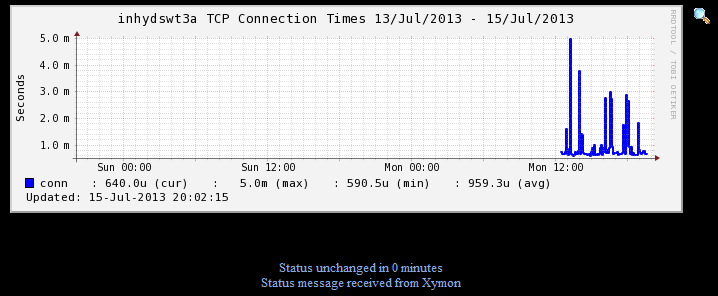

I'm not sure what you're asking about in relation to your switch.  You are
not able to run a Xymon client on the switch, and so Xymon can only perform
external checks, such as the ping/conn test.  If you want to have more data
about the switch, you can have an external script perform SNMP polling and
report into Xymon.  Typically this is done using the "Devmon" utility, see
http://devmon.sourceforge.net/

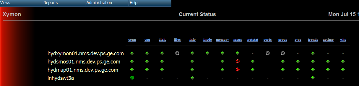

I also tried to add a network switch device in xymon, however it shows
conn is the only parameter to monitor.****
Refer below screenshot, inhydswt3a is the network switch that we added.***

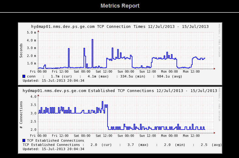

• Figure 2 shows: the trend it captured for switch.****
Figure 3 shows the trend metrics report for TCP connections.****

Figure1:****
Figure 2: inhydswt3a is the network switch****
Figure 3: hydmap01 is windows VM****

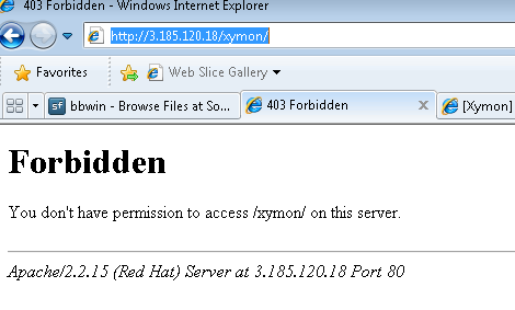

Again restarted xymon and httpd services and launched the URL. Getting
following error now.****
[root at hydxymon01 logs]# tail -f error_log****
[Tue Jul 09 13:45:07 2013] [error] [client 3.185.141.56] (13)Permission
denied: access to /xymon denied****
[Tue Jul 09 13:46:32 2013] [error] [client 3.185.141.56] (13)Permission
denied: access to /xymon/ denied****
Kindly advise.****
